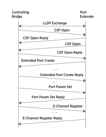

Example PE-CSP Protocol Exchange shows a typical PE-CSP exchange between a CB and a bridge port extender (BPE).
